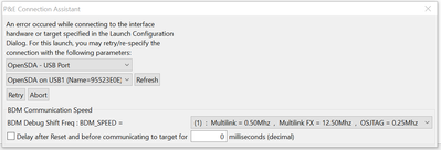

recently i was trying to do some memory functions with my S32K144EVB. by mistake, I have erased the entire p-flash memory. since then I am unable to load any programs to the board. every time I'm trying to do so the error shows that I am not able to connect with the board. additionally, the red LED near to MicroUSB (usual programming interface) is continuously on. please help me to resolve this. is this end of life for this EVB?

Can you show the error message that you get from the debugger?
Do you have any other debugger?

d_shivamkumar
it is not going beyond this point even after frequent retry.
