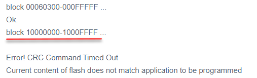

I'm using design studio, target is S32K146 , I was loading and running my project fine last night.
However when I tried to load and run again this morning, I keep getting the following:
Connection closed by the GDB server. and it fails to go through
This does not happen with other projects, I saw an earlier post recommending removing all the break points but that did not work for me.
What causes this to happen?

danielmartynek
HI Koorosh,
What debugger do you use?
Could you please specify what exactly was loaded the last time?
Thank you,
BR, Daniel

danielmartynek
Hi Koorosh,
I see that you posted it here as well:
PEG SERVER
From the console:

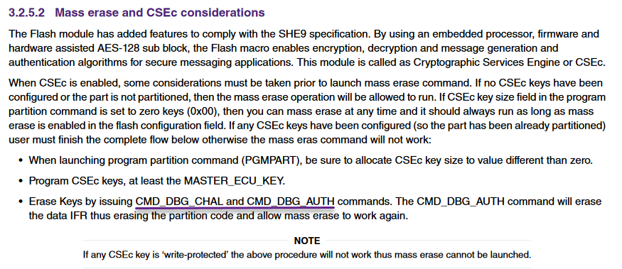

Does the project load something to DFlash?
If so, the MCU has been already partitioned for EEPROM and CSEc (key space allocated), you would need to erase the partition with this commands:
AN12130 Production Flash Programming Best Practices for S32K1xxMCUs
BR, Daniel

the part is patitioned and the Csec is enabled by the following: FTFC->FCCOB[2] = 0x03; /* FCCOB1 = 2b11, 20 keys */
However my question is howcome I can load and run other projects which are not enabling CSEC OR PARTITION THE PART.

danielmartynek
Hi Koorosh,
To my understanding, when the programmer is loading this project, it tries to reprogram DFlash, whereas all the other project don't. Could you share the project? You can create a ticket if you don't want to share it here.

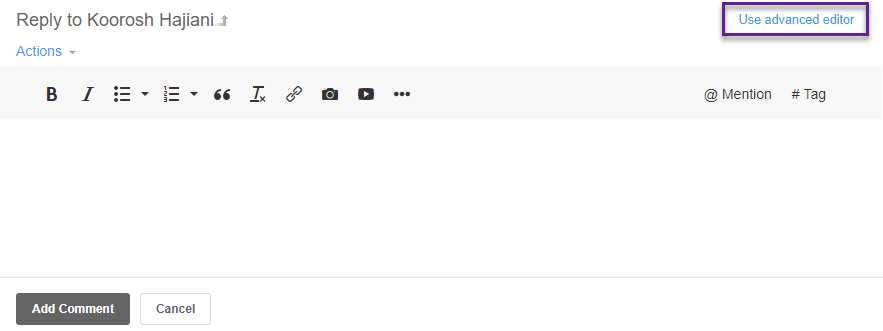

by the way, how do I attach a file to this question.

Maybe S-record of the project would help.
There is this Use advanced editor option:
BR, Daniel
