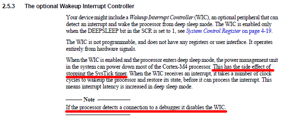

As per the Cortex™-M4 Devices Generic User Guide
And based on my testing, SysTick is stopped in STOP2 and can't wake up.
Also, SysTick is not listed in Section 7.3.1 AWIC stop and VLPS wake-up sources, S32K1xx RM, rev.9.
However, if a debugger is connected, the SysTick is running.
Can you try without the debugger?
