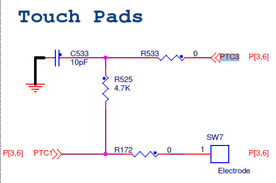

I need two S32K144-Board to communicate with each other by toggling a PIN, so that the routine I need on both boards can be synchronized. This doesn't work like I want to and I guess reading the PIN doesn't work.
I am using the PINs PTC14 (as input) and PTC3 (as output).

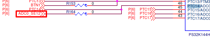

I am using the EVB but according to the QuickStart Guide (https://www.nxp.com/docs/en/quick-reference-guide/S32K144EVB-QSG.pdf ) page 5 it says J4-14 PTC14 is GPIO?
And when defining it as GPIO in the pin_mux:PinSettings it should work anyways in my opinon?

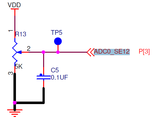

Yes, the pin can be used as GPIO input.
But anyway, the PTC14 pin is connected to the potentiometer and PTC3 is connected to one of the touch pads.

Do you use EVBs or your own boards?
On the S32K144 EVB PTC14 is connected the on-board potentiometer.
