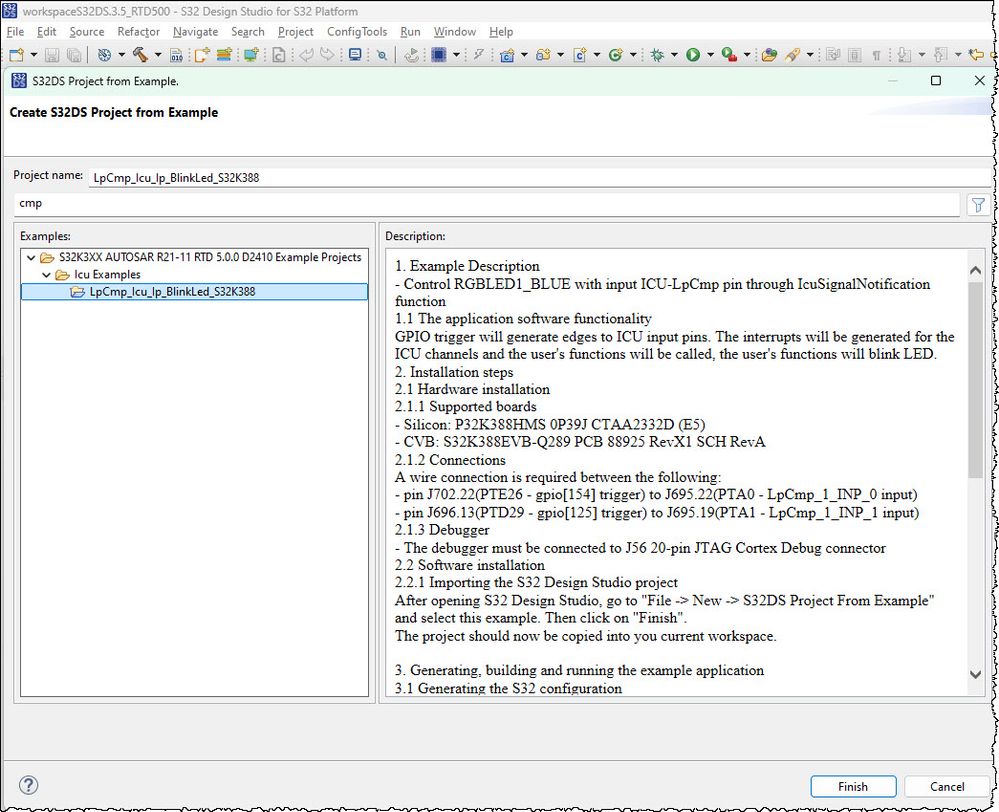

can anybody send me exmaple code for Comparator
1,079 Views
Robin_Shen
Please refer to the LpCmp_Icu_Ip_BlinkLed_S32K388 example in RTD.
