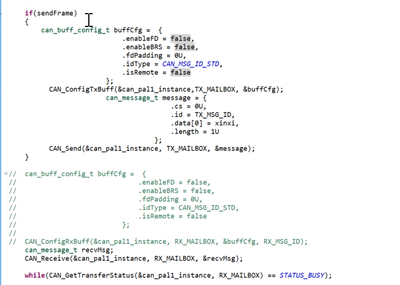

I am trying to communicate with the computer by CAN and UART. The codes are in the attachment and below. I would like to know why I have the situation in the picture

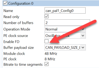

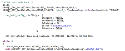

Modified:
Step1:
Step 2:
Step3:
result:
suggestion:

Sure, I'm in a situation where after running the code I can't send any data beyond the initial welcome message
