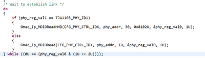

Hi , I am working on ethernet implementation with eval board S32K3X8EVB . My objective is to connect two eval boards and establish ethernet communication between them. Initially I was working with TCPIP 1.0.4 version. Later I updated to TCPIP 2.0.0 stack.
In version 1.0.4 , I observed this particular part of code in device_init() function
I take it that this while loop waits until link is established.
However , I dont find any such loop in the code in TCPIP 2.0.0 stack.
I observed that , even after switching off one the boards and debugging the other one, I could see the code entering into my application part , but technically it should not because the other board is switched off and there is no link.
It is not supposed to enter into my application part until link is established. Please someone explain this behaviour and give me clarity with respect to link startup and modifications in TCPIP 2.0.0

ssattva1
Hello @PavelL ,
Thank you for your reply . However , I still could not understand one thing. First of all this is a simple setup, I only have 2 boards connected and I am just trying to send an UDP packet to one of the boards from the other one.
My doubt here ,is that I observed that while debugging , the code entered the udp sending part when the other board was switched off. Yes , I particularly switched off the other board to make sure no packet is sent when link is not up.
In TCPIP 1.0.4 , device_init() function has the while loop for waiting till link established, hence without link establishment code would not move to start_example(). But in TCPIP 2.0.0 I didnt find such a loop . This is my doubt .
If such a loop is not necessary how do I know if link is up? Please clarify my doubt. Please mention if there are any differences in the implementation of version 1.0.4 and 2.0.0 of the tcpip stack

PavelL
Hello @ssattva1 ,
the situation is independent on the network complexity.
Your UDP routine shall be responsible for frame acknowledge: if your link partner didn't send UDP response/acknowledge in a given timeout, your UDP routine shall rise some error. Naturally, you may also check the link up before UDP frame is send, and rise an error immediately. Despite of TCP/IP stack version, I would modify the device_init() to not wait for link up. That's the way I would use.
