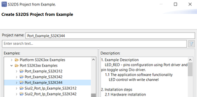

1) Open project from examples created by RTD
2) I select for example

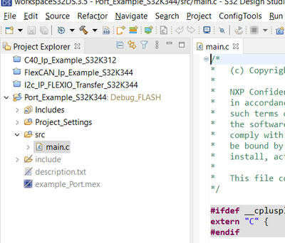

3) Now I can work with it
4) I can play with it and then I can decide to save and close it

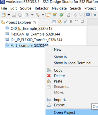

So right mouse button at project and select close.
5) Now the project is closed
6) When I want to open it again then I press right button at the project name, se;ect open project and I can work with it again

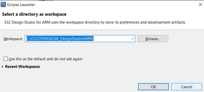

7) Of course you use some work space where your project are created from examples. This is mine....
