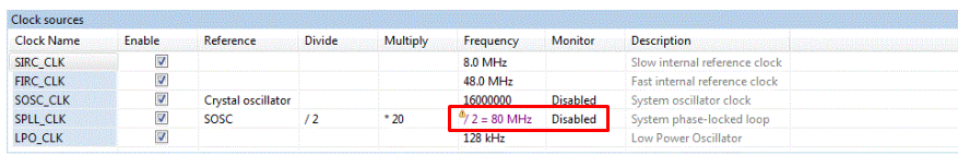

Hi ,
I am trying to config clock 80 Mhz ,my external clock 16 Mhz ,I have configured like below pic ...getting TIME_OUT FROM return status from
CLOCK_SYS_SetConfiguration() function .

Hi Rajesh,
The warning informs you that the SPLL_CLK frequency must be between 90 MHz and 160 MHz.
So, I recommend you to set the SPLL_CLK = 160 MHz and for SYS_CLK set SPLL_CLK/2. After that, you reach SYS_CLK = 80 MHz without warnings.
I hope it helps you.

Hi Rajesh,
However, I have seen in your attachment a warning below because the PLL frequency is not within the range.
Regarding your second question, could you please provide more information such as a piece of your code settings?

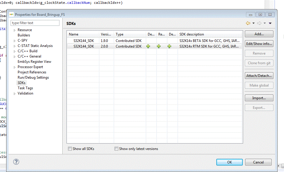

rajesh057
Hi Razvan-nicolae Tilimpea
Please find the following attachment.
6,994 Views
razva_tilimpea
Can can you mention what is the SDK version used in your project?
