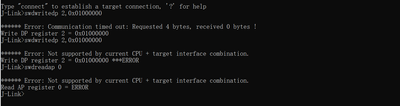

wutengyouxi555
I've tried unlocking with Jlink command but failed。
here is Console log:
Then I tried pulling the pin low using the command,also failed。
Console log:

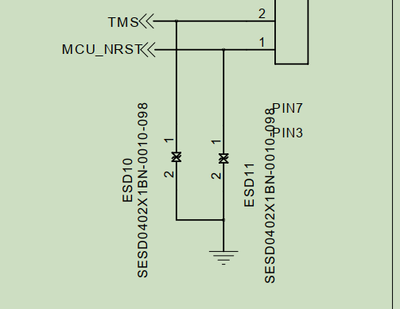

I measured the MCU_NRST pin voltage, result is 0.8V.(The board is energized).
Does that mean the MCU is damaged?

VaneB
Hi @wutengyouxi555
Please try to read the MDM_AP status and control registers, to verify the MCU status (Unbricking S32K146).

VaneB
Hi @wutengyouxi555
Unfortunately, there is a high probability that this is the case.
If you did not disable your reset pin maybe something can still be done.
For that, I would like to know if MCU_NRST is your RESET_b pin. If yes, the voltage you mention is very low so the MCU can no longer be recovered.
