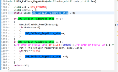

For example, I cannot see the local static variable UDS_ExFlash_PageWrite_step in the .map file. I am using S32K314.

Hi@zhlei327
From the test results, if the variable does not specifically specify the location where it needs to be stored, this will not be displayed in the map file.
