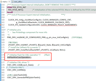

6. The bin file shows that the burning is successful, but the operation is not normal. Through S32DS-debug, it is found that the code for the flash partition cannot be executed during initialization, and it has been restarted there repeatedly.

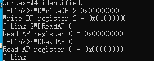

When reading the MDM-AP status register, it shows 0x00000000:

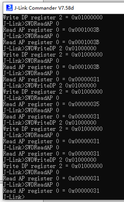

Perform mass erase on the chip and then read the display as:

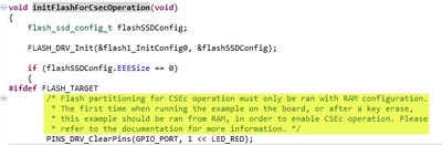

do you mean the code is executed from flash? There's a note in the initFlashForCsecOperation:
Maybe this is the reason.

     I met the same issue as the customer did. I exported the example from s32ds to IAR, and when I use the Ram.icf file. There is no problem. But when I use the flash icf for the first download or after the erase key. It happens something wrong in the  initFlashForCsecOperation.  But if we want to SOP, I think we will only use one icf file for IAR, and I don't know which functions should be put in Ram. I see there is a
START_FUNCTION_DEFINITION_RAMSECTION in front of the FLASH_DRV_CommandSequence. and it means FLASH_DRV_CommandSequence is put into Ram, but if still not work when using flash icf. Could you give me information and help about it ?

thankyou, I think this is the reason for this problem
