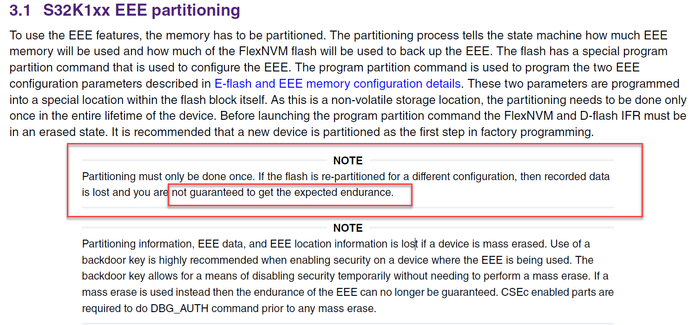

   When testing the S32K partition function, using the Project for Example to Debug, S32K partition successfully, but the EEPROM is not the size I want, can I restore the EEPROM to Flash?

yes ,you can restore the EEPROM to Flash again, but there are some riks.
AN11983 Using the S32K1xx EEPROM Functionality

    While enabling CSEc,I need to partition all 4KB FlexRAM into EEPROM,and partition 64KB FlexNVM into EEPROM backup.But while enabling Bootloader, I need to partition a portion of FlexNVM into the Bootloader.
    So what should I do if I want to Enabling both CSEc and Bootloader?  Can I partition 32KB FlexNVM into EEPROM backup,and 32KB for Bootloader?
Yes, but I recommend you partition the 2KB FlexRAM as EEPROM for expected endurance.
please note, create a new topic or case for your new question next time.

I tried to partition the 2KB FlexRAM as EEPROM,but the function FLASH_DRV_DEFlashPartition return STATUS_ERROR. How can I partition 2KB FlexRAM as EEPROM? Will this have an impact on CSEc?

Does you device is already  partitioned or not?  you can Read SIM_FCFG1[DEPART]
if yes, please try use mass-erase to restore partition settings first, then partition the flexram and flexvnm.
for example , if you want partition the 2KB FlexRAM as EEPROM and you enable CSEc at same time, only 2KB-512B space can be used as EEPROM, because CSEc will use up to 512B for key storage.
