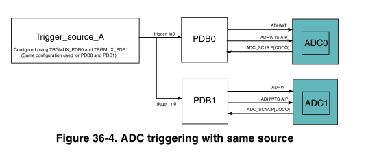

Hi support Team,
I am using  SD32K144 eval board.I wanted to use ADC0,ADC1 simultaneously in back to back to mode.I wanted to trigger ADC0 through PDB0 Channel0 and ADC1 through PDB0 Channel 1 in back to back mode.8 channel of ADC0 is working perfectly but Adc1 is not working kindly help me

to do simultaneous conversion on both ADC0 and ADC1 you have to trigger ADC by PDB0 and ADC1 by PDB1. Both PBDs can be triggered by the same source from the TRGMUX.
attached is simple code to do two simultaneous conversions on ADC0 and ADC1. Software trigger is used to start conversion.
