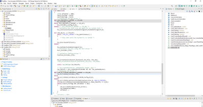

Hello All,
I’m working with the HVBMS RDK344BMU and trying to set up CAN communication. I’ve found a loopback example Can_Example_S32K344 , but I need to modify it for normal mode. Specifically, I want to observe the output on the CAN bus (VCU CAN).
Here are the steps I’ve taken so far:
Initialized the port . doing all routing :CAN0TX +CAN0RX + SPIS5 PCS2
Configured pins for VCU Can.
Set up the CAN: Disable loopback.
Tried transmitting data.
However, I’m not getting the expected results. Could someone guide me on how to modify the example for normal mode and troubleshoot the issue?
the CAN is always busy
Any help would be greatly appreciated!
Thank you,

my main code:
int main(void)
uint8 u8TimeOut = 100U;
CanIf_bTxFlag = FALSE;
CanIf_bRxFlag = FALSE;
/* Initialize the Mcu driver */
#if (MCU_PRECOMPILE_SUPPORT == STD_ON)
Mcu_Init(NULL_PTR);
#elif (MCU_PRECOMPILE_SUPPORT == STD_OFF)
Mcu_Init(&Mcu_Config_VS_0);
#endif /* (MCU_PRECOMPILE_SUPPORT == STD_ON) */
/* Initialize the clock tree and apply PLL as system clock */
Mcu_InitClock(McuConf_McuModeSettingConf_McuModeSettingConf_0);
/* Initialize all pins using the Port driver */
Port_Init(NULL_PTR);
/* Initialize CanIf driver */
CanIf_Init(NULL_PTR);
#if (MCU_NO_PLL == STD_OFF)
while ( MCU_PLL_LOCKED != Mcu_GetPllStatus() )
/* Busy wait until the System PLL is locked */
Mcu_DistributePllClock();
#endif
Mcu_SetMode(McuModeSettingConf_0);
/* Initialize Platform driver */
Platform_Init(NULL_PTR);
static Can_PduType Can_PduInfo;
/* Can_CreatePduInfo(id, swPduHandle,length, sdu) */
Can_PduInfo = Can_CreatePduInfo(0U, 0U, 8U, Can_au8Sdu8bytes);
/* Initilize Can driver */
#if (CAN_43_FLEXCAN_PRECOMPILE_SUPPORT == STD_ON)
Can_43_FLEXCAN_Init(NULL_PTR);
#else
Can_43_FLEXCAN_Init(&Can_43_FLEXCAN_Config_VS_0);
#endif
Can_43_FLEXCAN_SetControllerMode(CanController_0, CAN_CS_STARTED);
while(count<20)
if((Can_43_FLEXCAN_Write(CanHardwareObject_1, &Can_PduInfo) == E_OK))
/* Wait until the message is successfully sent */
//while(!CanIf_bTxFlag)
while((!CanIf_bTxFlag) && (u8TimeOut != 0U))
Can_43_FLEXCAN_MainFunction_Write();
Can_DummyDelay(100U); /* Optional delay */
u8TimeOut--;
/* Reset the flag for the next transmission */
count++;
Can_DummyDelay(1000U);
Can_43_FLEXCAN_SetControllerMode(CanController_0, CAN_CS_STOPPED);
Can_43_FLEXCAN_DeInit();
Exit_Example((CanIf_bTxFlag && CanIf_bRxFlag) == TRUE);
return (0U);
If you have other idea, please tell me generously.

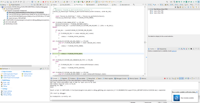

Could you share how you are measuring the output? Are you using an oscilloscope/logic analyzer or a CAN Analyzer?
Keep in mind that for user/normal mode a second node (another MCU or CAN Analyzer) must be connected to the bus line. You can use Example S32K344 FlexCAN_Ip TX/RX/EnhanceRXFIFO test S32DS3.4 RTD200 as reference for configuration.
Julián
7,351件の閲覧回数
AchrafOukheir
Hi Julián,
Thank you for your prompt response! I appreciate your assistance.
Regarding measuring the output, I am currently using a logic analyzer. Initially, I attempted to work with the VCU CAN, but encountered issues out put always LOW. Consequently, I switched to the CMU and BJB CANs, which provided some output visible in the logic analyzer.
However, I’ve noticed that the measured output consists of error messages. Do you have any insights into why this might be happening? Your guidance would be greatly appreciated.
its the same main code of the Can_example , you can see that on the zip attached
Best regards, Achraf
