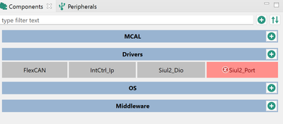

First of all, the provided example uses modules from category "Drivers" whether my example uses modules from category "MCAL"
screenshot from provided example
In understood, that inside function setupCanXCVR(), the initialising of the TJA1153 transceiver is covered, and that this must be done before i can use the CAN Bus.

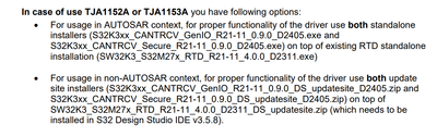

This example seems to setup also the TJA1153 Transceiver. It does so by using an MCAL module "CanTrcv_43_GenIo" together with some manual code located in file src/cantrcv_tja_115x.c (especially the function  CanTrcv_43_Tja115x_Setup)
Also the documentation of the CanTrcv_43_GenIo mentions:
that this should be possible.
Could you confirm, that i can go this way to setup a functional CAN communication?
Or is it a better approach to use modules from category "Drivers" instead of "MCAL"?
And could you please provide a download link for "S32K3xx_CANTRCV_Secure_R21-11_0.9.0_DS_updatesite_D2405.zip", i can't find it in the product search.
This is because the RTD drivers provide two examples to use as reference, the low-level driver (LLD or IP) and high-level driver (HLD or MCAL).
The example I showed was the FlexCAN_Ip_Example_S32K344. You can see the "IP" included in the example name, which means it is based on the IP drivers, not MCAL.
Your example name must be Can_Example_S32K344, which does not show the "IP" in the name, meaning that example is based on MCAL.
Yes, I see no problem using the driver package to setup the CAN transceiver.
You can use whichever you have available (access to drivers) and find easier to configure. I referenced you to the FlexCAN examples and community post since it is the basic example we refer for CAN applications.
I cannot provide the link since the CANTRCV Secure is under secure access. In order to request secure access rights, please follow the following page: Secure Access Rights | NXP Semiconductors.
