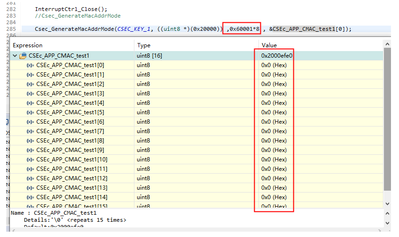

Is there any length limitation of CMAC calculation by Csec_GenerateMacAddrMode?
Can the calculation length be beyond 0x60000?

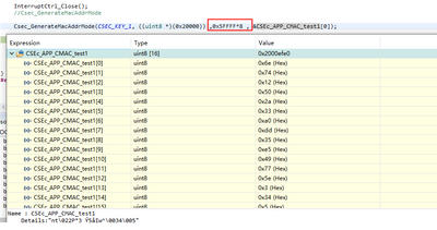

Length 0x5FFFF, it can work.
Length 0x60000, it can work.
Length 0x60001, it can't work.

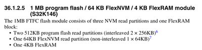

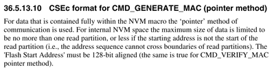

yes, there is a limitation:
 In case of S32K146, there are two 512KB read partitions in program flash:
So, you just crossed the partition.
