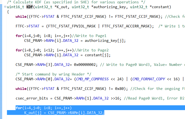

   In AN-5401 some of the examples read the output data from PRAM Page-1 where as in some other example the output is read from Page-2. May I know the rational behind this different approach?.
Also Kindly provide any documentations related to this.

see the description of CSE commands in the reference manual:
https://www.nxp.com/docs/en/reference-manual/S32K-RM.pdf
For example, this is description of CMD_GET_ID command where you can see which pages are used and what is the purpose:
And here you can see it corresponds with the code from AN5401:
