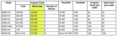

When I was using the GenerateMACAddrMode function of CSEC.When the address value exceeds 0x7DFFF, an error will occur. Is this normal?

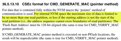

It's a limitation of the CMD_GENERATE_MAC command in Addr mode (also called pointer method):
The partition (i.e. block size) can be 128KB, 256KB or 512KB depending on derivative:
Lukas

SaLan
My fault
I means can't out of 512kb
CSEC_DRV_GenerateMACAddrMode(CSEC_RAM_KEY, (uint8_t *)0x0007FFFC, 0x00000080, (uint8_t *)cmacout);
but i use addr = 0x0007FFFC, len = 0x00000080
also no error,but out of range
