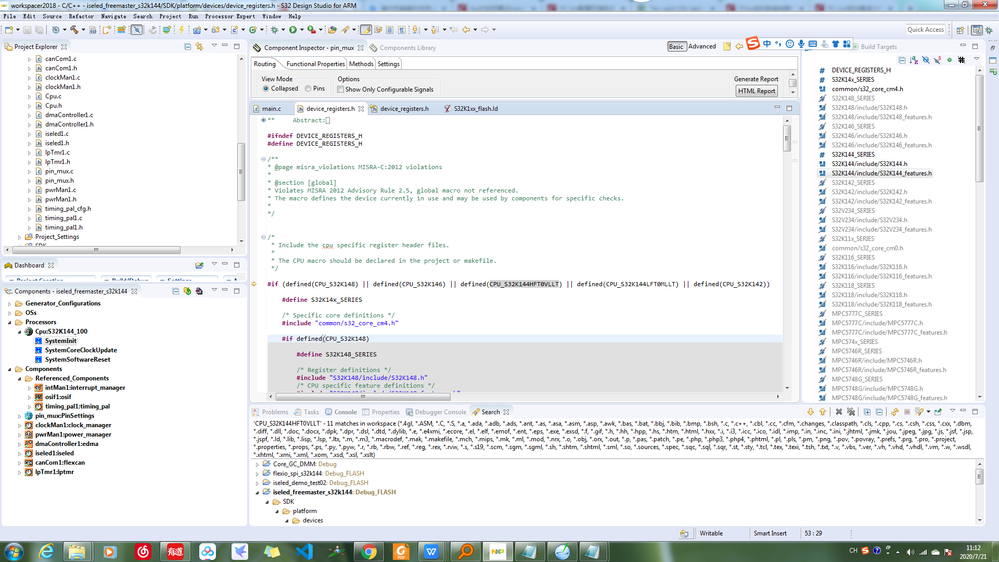

I can‘t open declaration of CPU macro.Could you help me to find where it exist?

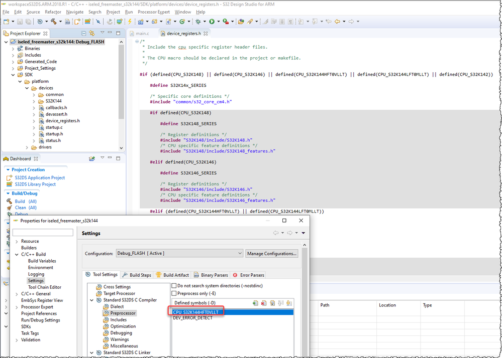

Hi 唐 敏俊,
Robin
2,702 Views
allennmk
Oh,Thank you .Is there a visible file edit this definition?I want add the path of that file to source insight for static testing.Because it shows it can't find the definition of CPU.
