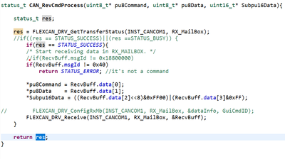

I am using FLEXCAN_DRV_GetTransferStatus(INST_CANCOM1, RX_MailBox) function when  sent data from microchip canalyser getting STATUS BUSY always  and returning res as status busy.
Below is the attached copy of the function  we are using please support the issue to solve the problem.

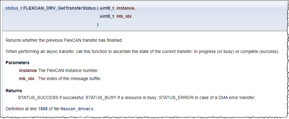

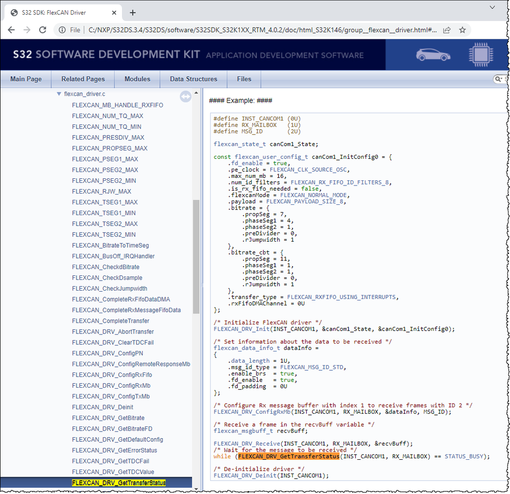

Did you start receive before calling FLEXCAN_DRV_GetTransferStatus?
status_t FLEXCAN_DRV_GetTransferStatus.pngstatus_t FLEXCAN_DRV_GetTransferStatus.pngFLEXCAN_DRV_GetTransferStatus.pngFLEXCAN_DRV_GetTransferStatus.png
C:\NXP\S32DS.3.4\S32DS\software\S32SDK_S32K1XX_RTM_4.0.2\doc\Start_here.html
Robin

I Did not  start receive before calling FLEXCAN_DRV_GetTransferStatus
just calling this function from main
CAN_RevCmdProcess(&u8Command, &u8Data, &u16SubData);
This is BCC Eval driver software .In this send function is working were as Recieve code is not working.
Robin
