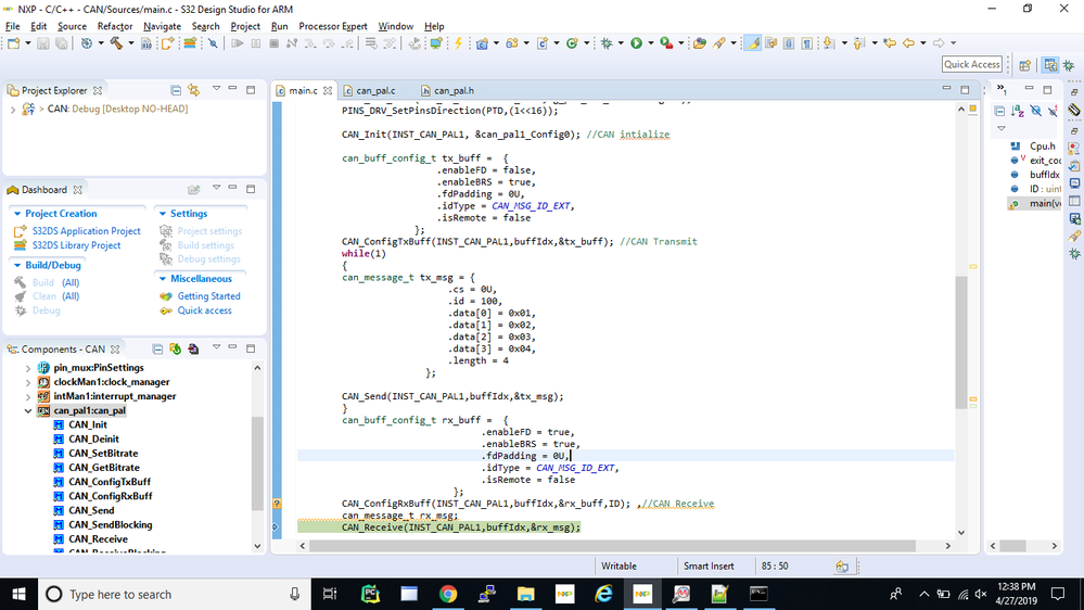

 i am using FS32K144 EVB board and i want how to transmit and receive can messgae in a simple manner.Can u please hlp me to code??? i tried something below in my code.
2,289 Views
intern_praveena
I am not able to receive can msg?? but transmission is working.How to i solve??,here is my code,Screenshot (100).png
2,289 Views
PetrS
seems you are using same MB for TX and RX operation. Use one MB for TX and another for RX. In your code it is buffIdx variable used in all functions.
