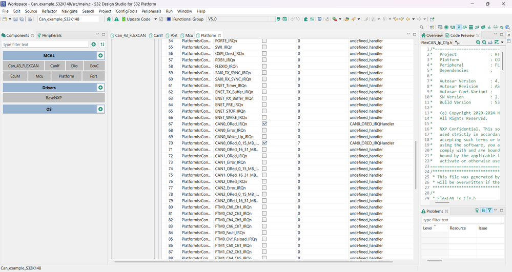

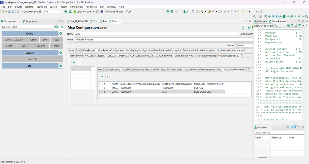

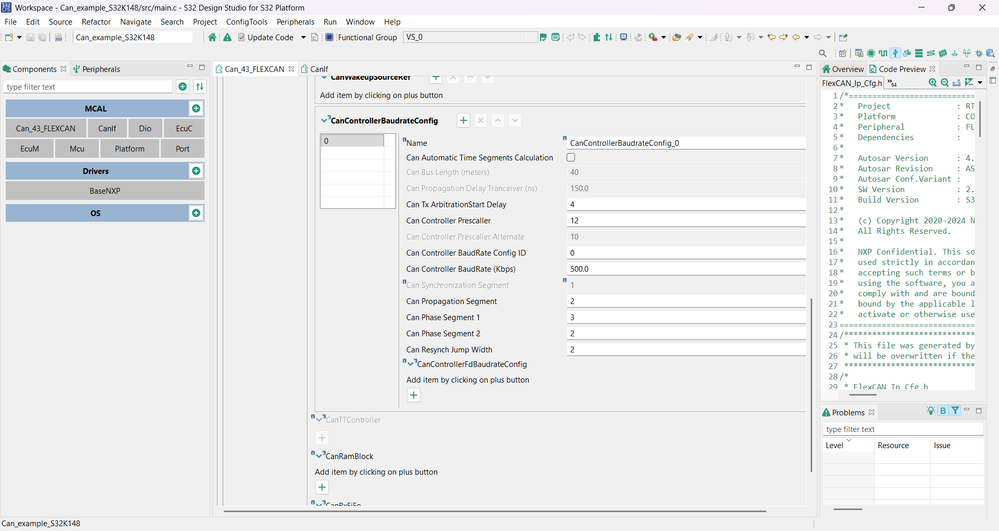

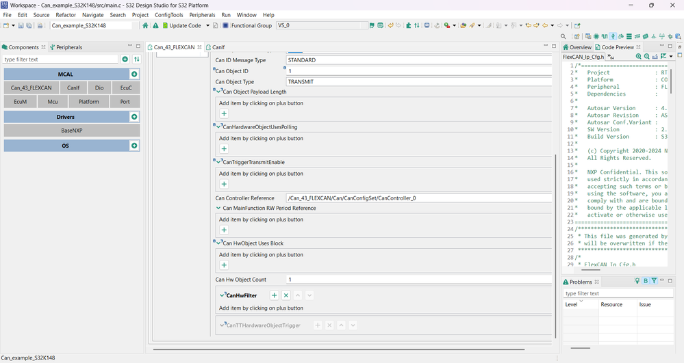

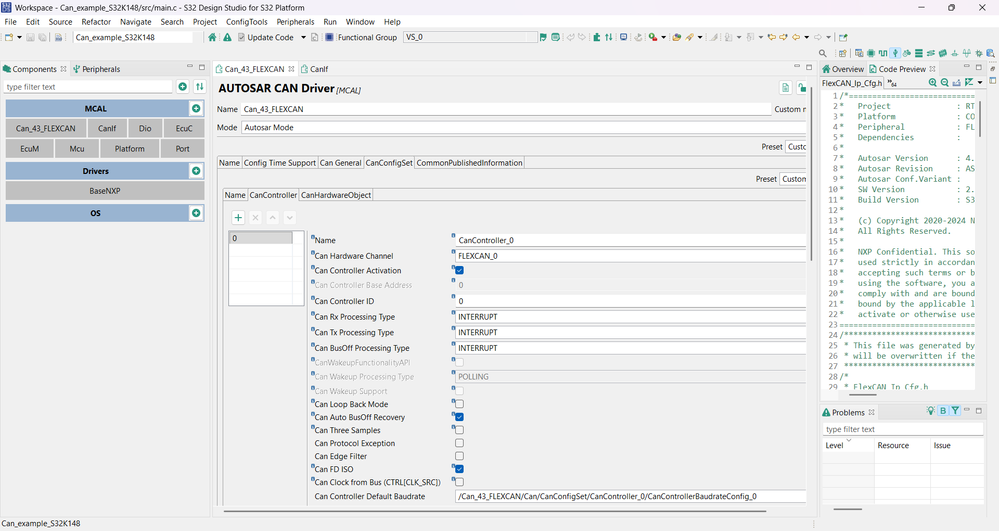

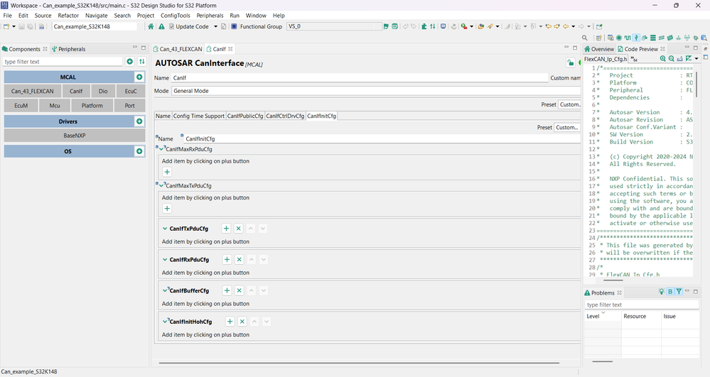

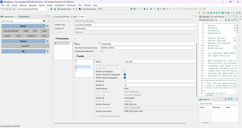

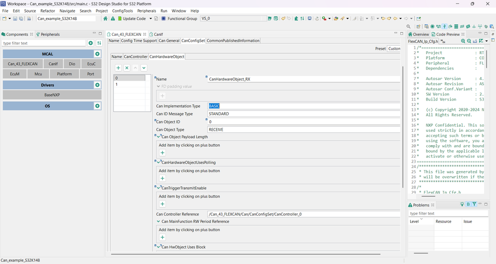

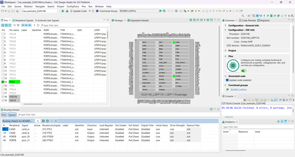

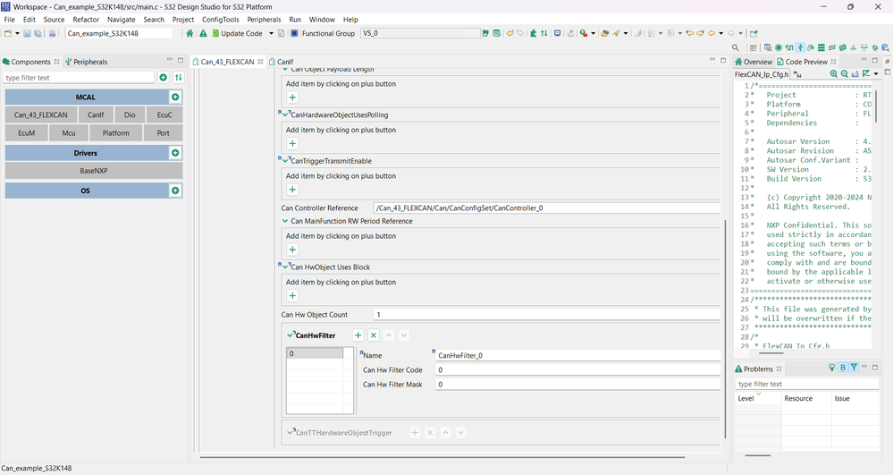

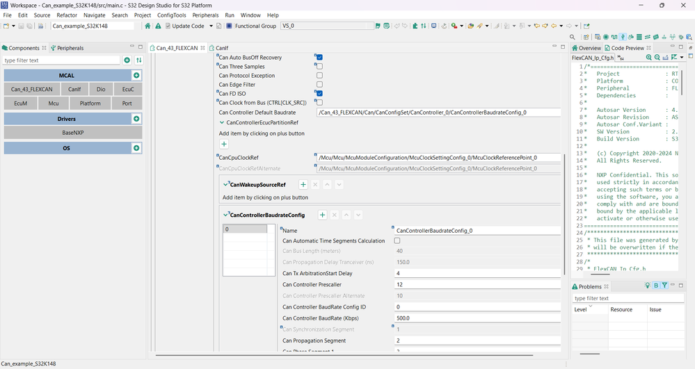

Hii,
  Here I am trying to transmit some dummy data from S32K148 to USBCAN_FD Tool using standard CAN, but I am not able to receive any data at the tool and when I am debugging the code I am getting CAN clock not sync, so can you tell me where did i made the mistake and also here I am using TJA1042B CAN transducer. and I have configured it to active mode by setting the pin low.
And also I will share my code and Pics of the config what I did.Screenshot 2025-11-13 054731.pngScreenshot 2025-11-13 054731.pngScreenshot 2025-11-13 054924.pngScreenshot 2025-11-13 054924.pngScreenshot 2025-11-13 054936.pngScreenshot 2025-11-13 054936.pngScreenshot 2025-11-13 054954.pngScreenshot 2025-11-13 054954.pngScreenshot 2025-11-13 055009.pngScreenshot 2025-11-13 055009.pngScreenshot 2025-11-13 055021.pngScreenshot 2025-11-13 055021.pngScreenshot 2025-11-13 055107.pngScreenshot 2025-11-13 055107.pngScreenshot 2025-11-13 055119.pngScreenshot 2025-11-13 055119.pngScreenshot 2025-11-13 055139.pngScreenshot 2025-11-13 055139.pngScreenshot 2025-11-13 055154.pngScreenshot 2025-11-13 055154.pngScreenshot 2025-11-13 055232.pngScreenshot 2025-11-13 055232.pngScreenshot 2025-11-13 055251.pngScreenshot 2025-11-13 055251.pngScreenshot 2025-11-13 055313.pngScreenshot 2025-11-13 055313.pngScreenshot 2025-11-13 055743.pngScreenshot 2025-11-13 055743.png

3 返答(返信)
1,549件の閲覧回数
Senlent

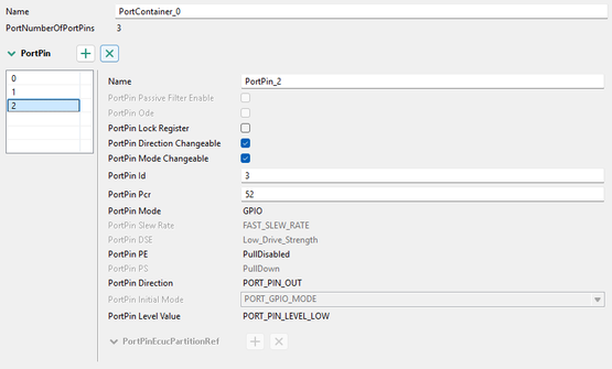

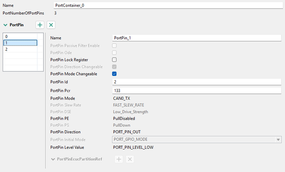

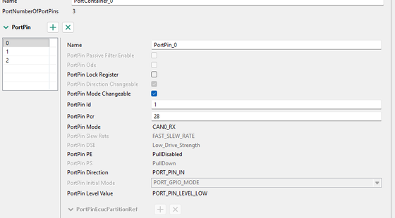

Hi@Vamshi_
Your "Port" configuration is wrong, please refer to below configurations.
Senlent_0-1763102788099.pngSenlent_0-1763102788099.pngSenlent_1-1763102794984.pngSenlent_1-1763102794984.pngSenlent_2-1763102810362.pngSenlent_2-1763102810362.png
1,583件の閲覧回数
Vamshi_
This is my project file.
1,591件の閲覧回数
Senlent
Hi@Vamshi_
Please share your project , and I will take the time to check it for you.
