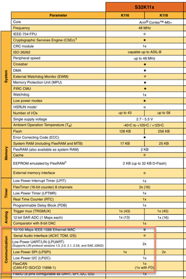

Hello all,
we are Working on Urgent Project
Controller :s32k116
Complier: IAR
In our project  having  Two ECUs for example one is' A' and Another one is 'B '.here A is CAN Based Bootloader and B is Lin Based Bootloader .we need to flash the LIN Bootloader via A to B .if any one Knows   please help me how to receive date from Via A to B .

In our Project Customer demand to implement CAN to LIN Gateway Communication.
we need to Reprograming(UDS ) application via ECU1(Maser ) CAN communication to ECU2(Slave) LIN communication.
we are Requesting to NXP team for demo Project for CAN to LIN Gateway communication

Ok, I can understand now. Closest option is mentioned AN12323 where one S32K board works as gateway node and second as edge node. CAN interface is used between the nodes. I'm afraid there are no other demo codes.

if we are talking about bootloader, currently these resources are available:
https://www.nxp.com/docs/en/application-note/AN12218.pdf
https://www.nxp.com/docs/en/application-note-software/AN12218SW.zip
https://www.nxp.com/docs/en/application-note/AN12323.pdf
https://www.nxp.com/docs/en/application-note-software/AN12323SW.zip
https://www.nxp.com/downloads/en/snippets-boot-code-headers-monitors/unified_bootloader_framework.zi...
If you want to load data from A to B, there are not many communication interfaces on S32K116:
CAN is already used, UART is relatively slow, so SPI would be my choice.
