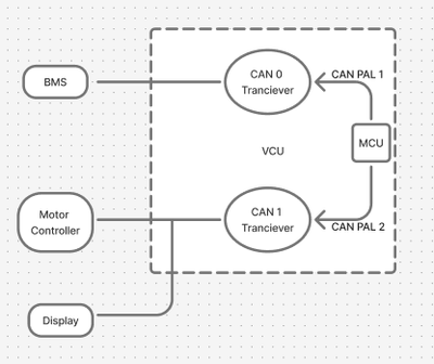

Can someone help me with the following.
I am writing a firmware for a prototype level electric two wheeler coustom VCU(S32k146) . I am using S32DS with EAR SDK 0.8.6.
Brief Architecture

System Architecture
Based on your schematic:
  • VCU (S32K146): Contains CAN PAL 1 (CAN 0 Transceiver) and CAN PAL 2 (CAN 1 Transceiver)
  • BMS: Connected via CAN PAL 1
  • Motor Controller: Directly connected to Display via shared CAN bus
  • Display: Connected to shared CAN bus with Motor Controller
  • CAN PAL 2: Connected to the same shared bus as Motor Controller and Display
  • Important Note: VCU does NOT receive or acknowledge Motor Controller data - it only transmits on this shared bus
  • CAN Analyzer: Connected to CAN PAL 2 bus during testing

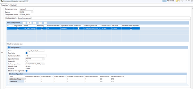

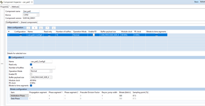

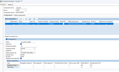

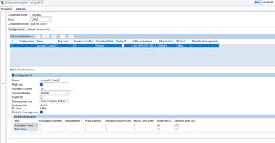

akhilranga_0-1759469245611.pngakhilranga_0-1759469245611.pngakhilranga_1-1759469265289.pngakhilranga_1-1759469265289.png
These are the configuration settings of the CAN PAL1 and CAN PAL 2 of the main project where the CAN issue is being noticed. Is this what you wanted me to confirm for both the nodes.
And follow up to this i will be adding the sample project code below where the data was seen successfully transmitted.

 the below are the CAN Nodes settings for the Test Project where the scucessful transmission is observed
P.S : I understand the limtations for support for the custoum implimentation. And i really appriciate your help. This is just a technical enquiry and trying to gain knowledge on what is that i am doing wrong. Just wanted another set of hands to assess this issue for me. Thank You

Looking at your CAN configuration between projects, it is exactly the same, correct?
How exactly are you testing communication? Going over the first code snippet you've shared, you have, Monitoring_Vehicle_CAN() function commented, meaning If there’s no RX traffic on CAN0, you’ll never see CAN2.
Since configuration is the same, and the issue probably comes from main routine; if you have already a working project, my suggestion is to build from it your application project.
