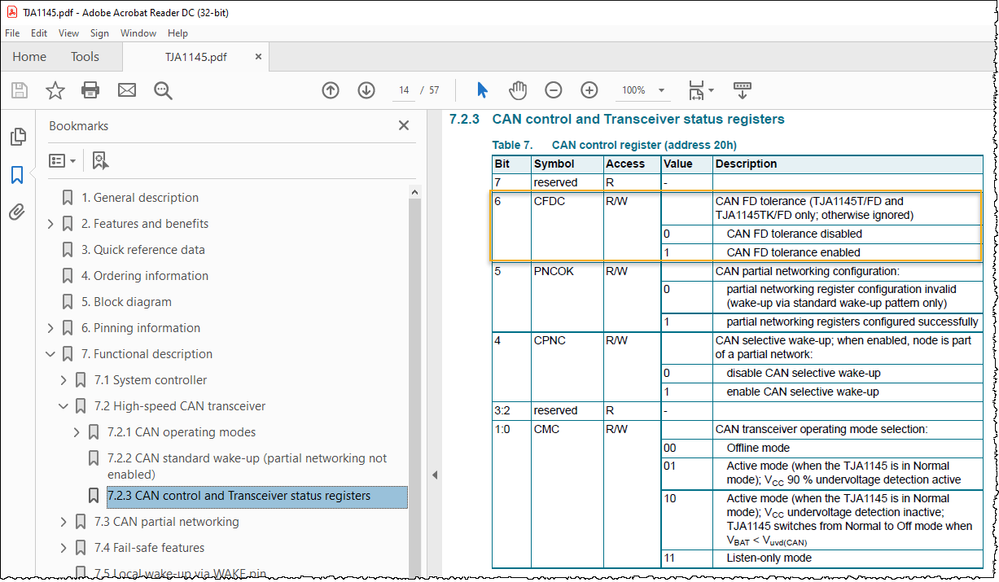

Hello, NXP support,
Now I am debugging CAN-FD&TJA1145FD using s32k144. The phenomenon is as follows.
S32K144 + CAN-FD + TJA1043
→CAN-FD communication(send/receive) is successful.
S32K144 + CAN + TJA1145FD
→CAN communication(send/receive) is successful.
S32K144 + CAN-FD + TJA1145FD
→CAN communication fails.
→PC CAN Box Tool displays “error frame" in output window.
→TJA1145FD 's TX pin has waveform, but it is different from the waveform of CAN-FD&TJA1043.
<Question>
Why does the communication fail when MCU uses CAN-FD&TJA1145FD ?
Is there any difference in the control method or configuration method of TJA1145FD when MCU uses CAN and CAN-FD?

chengsz12060
I have checked the CFDC of  20h.
CAN-FD comunication fails if CFDC = 0.
CAN-FD communcaiton also fails if CFDC = 1.

Robin_Shen
Hi chengsz,
Please check the CFDC of CAN control and Transceiver status registers. Here is the Data Sheet of TJA1145.
