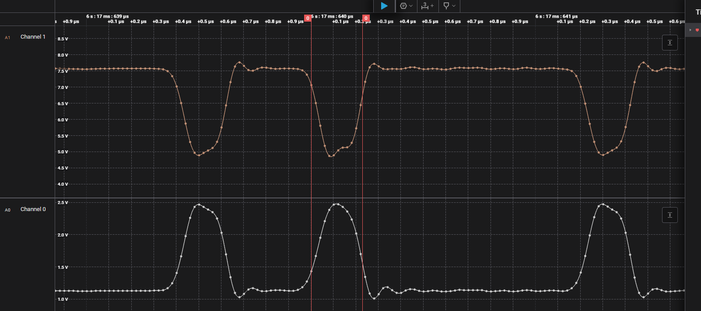

Tomato1
I changed the CAN transceiver from TJA1443 to TJA1462, which supports 8 Mbps, and retried. Up to 4 Mbps, transmission works normally, but when set to 5 Mbps, as shown in the image below, a waveform is transmitted for an instant, and then nothing is sent afterward. I would like to know the cause and how to resolve this.
At 5 Mbps, the waveform pattern changes midway.

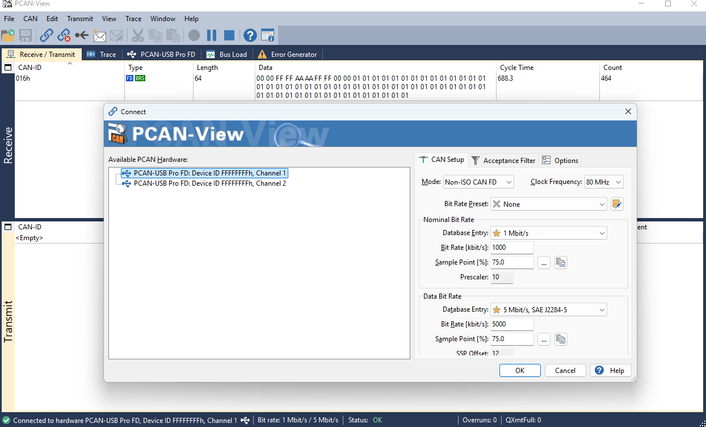

Senlent
Hi@Tomato1
I can't test the 8MB for you, but I tested the 5MB on the S32K3X4EVB with your configuration, and it worked perfectly.
8,057件の閲覧回数
Tomato1
I have reviewed the attached file.
I was able to replicate the same operation,
but when checking the waveform with an oscilloscope, it shows a bit width of 1us, and the data phase appears to be transmitted at 1Mbps.
When setting "brs" to TRUE, the transmission stops midway through the waveform.
Please check it.

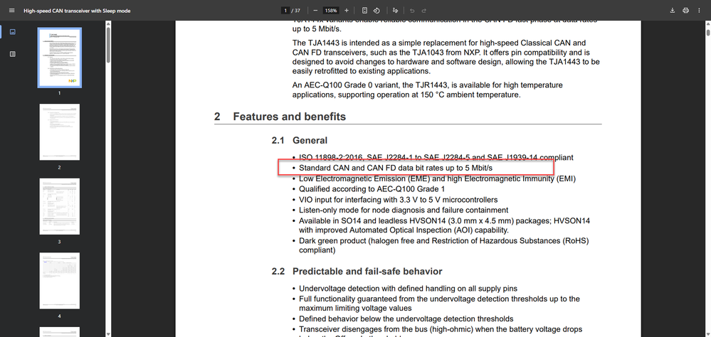

Senlent
Hi@Tomato1
TJA1443 is used in S32K3X4EVB-T172 and i can see the speed limited on TJA1443.
This could be the reason why 8Mbps can not run successfully.
8,374件の閲覧回数
Tomato1
Thank you for your response. I will replace the CAN transceiver with one that supports 8Mbps and try again.
