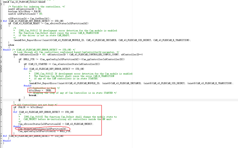

HI.
I attempted to shut down the CAN controller before the BOOTLOADER jumped to the APP, but when I called CAN_DeInit, it actually wasn't re-initialized, resulting in incorrect frames being sent on the CAN bus after the jump. I would like to know if there are any problems with this logical judgment. I have set CtrlState to TRUE, but the reverse initialization requires it to be FALSE in order to execute.CAN_DeInit.png

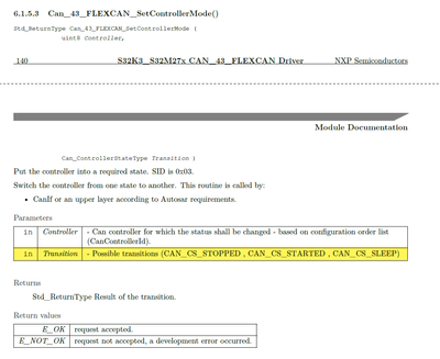

Julián_AragónM
Hi @Embedded_novice,
Before calling CAN_DeInit, set all controllers to STOPPED to allow it to de-init properly:
/* Stop Can controller */
Can_43_FLEXCAN_SetControllerMode(Can_43_FLEXCANConf_CanController_CanController_0, CAN_CS_STOPPED);
/* De-Initialize Can driver */
Can_43_FLEXCAN_DeInit();
Julián

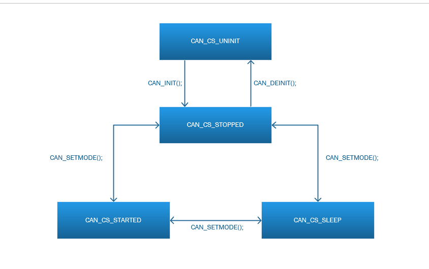

I understand your train of thought now. I would like to know if this state transition diagram is correct. Additionally, I have two more questions:
1. Where can I find this state transition in the manual of the MCU? I didn't see any similar state description in the RM.
2. Is this state transition mandatory? Is the same processing logic applied in other MCU architectures?

Julián_AragónM
Hi @Embedded_novice
1. The controller modes are defined in the AUTOSAR specification, thus described in the FlexCAN MCAL driver user manual found under the following path: "C:\NXP\S32DS.3.X.X\S32DS\software\PlatformSDK_S32K3\RTD\Can_43_FLEXCAN\doc\RTD_CAN_43_FLEXCAN_UM.pdf"
2. By AUTOSAR standards, yes, it is mandatory. The processing logic depends on the driver implementation. For example, in the FlexCAN driver, functions called are FlexCAN_Ip_SetStartMode() and FlexCAN_Ip_SetStopMode(), both of which enable and disable the module, respectively.
AUTOSAR specification also provides a transition diagram in their CAN specification document:
Julián
