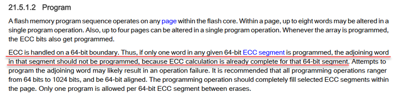

danielmartynek
Hi @chenyuhang,
This is what the C40 HW requires (S32K3xx RM rev.11)
The C40_Ip driver (C40_Ip_MainInterfaceWrite()) has these checks:

Hi @chenyuhang,
The C40_IP driver is the lowest-level driver we have.
What data length do you intend to write?
  • It cannot be shorter than 8 bytes, as this is a hardware limitation
There is no restriction for reading from flash—use C40_Ip_Read() for that.

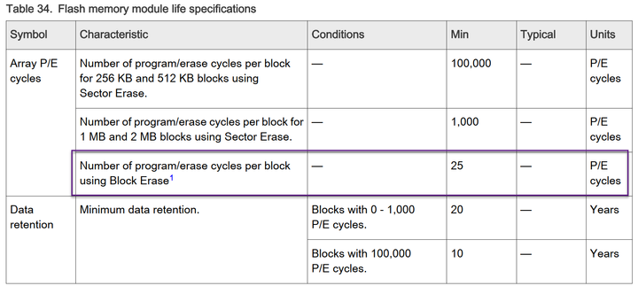

What issue are you experiencing with the erase operation?
  • Sector erase is the only option - block Erase does not have the cycling endurance.
