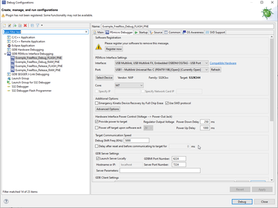

Hello ,

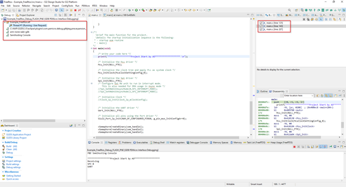

I can 't have an enabled breakpoint , also FreeRtos tasks (threads) I can't see them however. I create 4 tasks.
Maybe it's not well configured. I am based on the Freertos s32k344 example.
maybe my debugger doesnt support FreeRtos, my debugger is :

Hi @AchrafOukheir
According to the shared images, looks like you have selected the Skip All Breakpoints. This command marks all breakpoints in the current view as skipped. Breakpoints marked as skipped will not suspend execution.

Thank you. If the breakpoints are resolved, the FreeRTOS debugging features will work.
