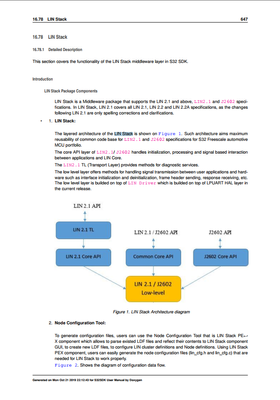

fanziyu
MCU:S32K144
IDE:S32 Design Studio for ARM   version:2.2
SDK:3.0.0
Is there any application notes for lin stack of S32K144? like AN5122 for Magniv family.
More over what is the meaning of  "Care must be taken no to use the same timer that the driver uses for the schedule." on page 13 of AN5122.
Thanks!

Just my opinion, this line should be "Care must be taken to not use the same timer that the driver uses for the schedule"
So a required timer will be being used for the purpose of a routine following a schedule table, and you need to be carefully not use the same timer for other tasks.

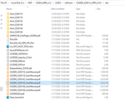

Hi fanziyu,
Currently i just found a chapter of LIN stack inside the User manual document of the K144 derivative, for SDK 3.0.0
Please help me take a look.
About the line in AN5122 i'm not so sure due to it's a old document and i'm not familiar with Magniv family.
One possible reference is User manual document of LIN stack package released recently. So is this possible for you to use the new version of LIN stack?

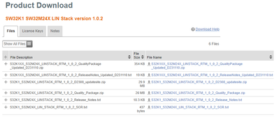

Jimny
Hello NamLee,
Could you please tell me the link to the latest user manual of lin stack package? I have downloaded S32SDK_S32K1xx_RTM_4.0.2.exe and could not find it.
BR.
3,436件の閲覧回数
NamLee

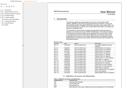

I think you're asking for the latest LIN stack package. You you can find it here
Design : Product Download : Files (flexnetoperations.com)
Then you can find the User manual inside the package.
Please help me to check this one.
Thank you,
Nam.
