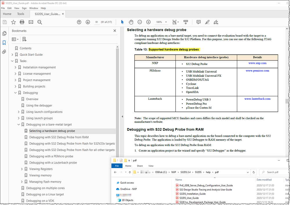

Hello, I have a question due to debugging problems with my probe. I have CMSIS-DAP probe based on LPC11U35 uC. The MCUXpresso software detect's it as LinkServer probe, and works fine. I would like to add that debugging configuration to S32DS platform to debug S32K144 with it. Is that possible? I read threads like this https://community.nxp.com/t5/S32-Design-Studio/Debugger-options-for-S32DS/td-p/648501 but it's not working.
Would apprecitate any help

I tried very different ways to make it work, even I tried to make fresh Eclipse workbench including S32DS features along with MCUXpresso features, but none of them succeed. Guess that I need to buy some other probe.

Sorry, this debug probe is not in the support list of S32 Design Studio for S32 Platform 3.4, so you can not achieve it.
You can find the Supported hardware debug probes in S32DS_User_Guide.
