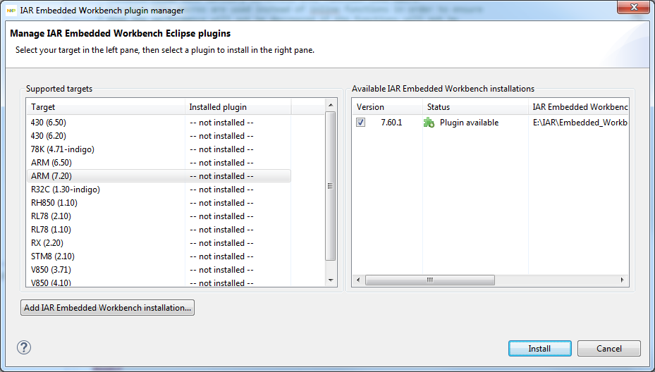

  1. First, you have to install IAR Embedded Workbench for ARM on your machine. You can start with Evaluation version of IAR Embedded Workbench
  2. Then install the IAR plug-in manager: IAR Embedded Workbench for Eclipse
  3. Finally install the ARM target plug-in:

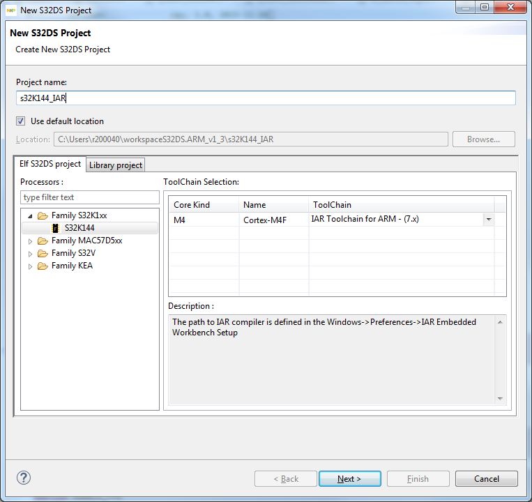

when the plug-in is installed restart S32 Design Studio and the new project wizard should offer IAR build tools and IAR debugger options:

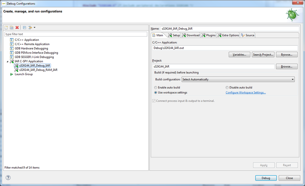

Now if you build the project and go to the available debug configurations you can see IAR C-SPY config:

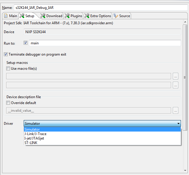

and it offers following devices (I-Jet is supported) :

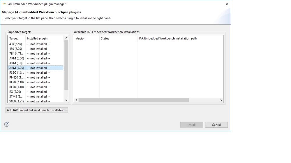

koehlerl
Hello Stanislav,
I can't Install the IAR Plugin in the S32DS. There is no plugin available. I have the D32DS Version 1.3.
What can I do, that it works like in your example above.

stanish
Hi Lutz,
Thanks for your comment.
I forgot to mention you have to install IAR Embedded Workbench before you start plugin installation.
In order to use IAR eclipse plug-ins in S32 Design Studio you need to have IAR Embedded Workbench installed on your machine.
You can start with the evaluation version: IAR Embedded Workbench
Hope it helps.

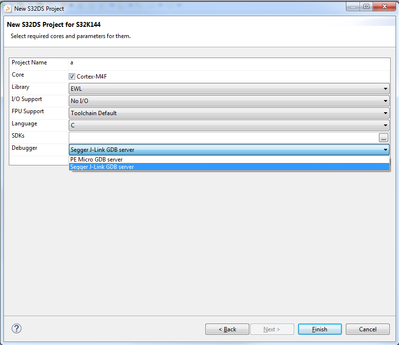

martin_kovar
Only S32 Design Studio for ARM version 1.2 supports PE Micro GDB server and also Segger J-link GDB server. While you are creating a project, you can choose the GDB server you want to use in project wizard. See figure below.
If you have any other questions, please feel free to write me back.
