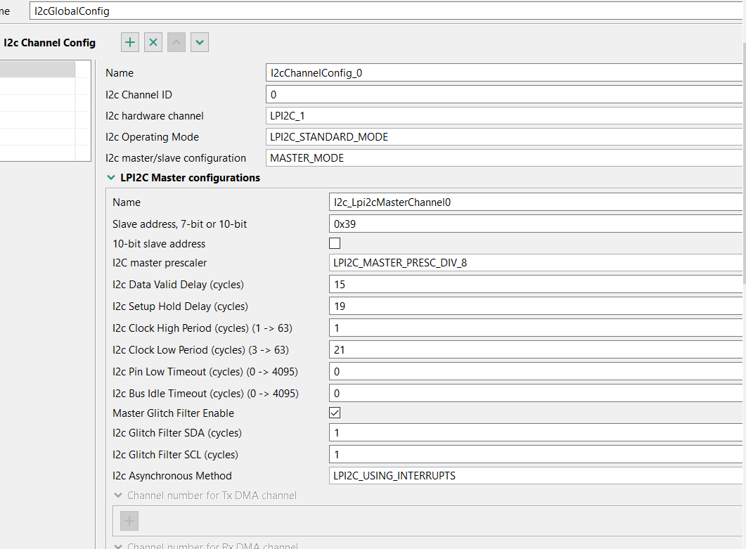

I am confused on how to add multiple slaves devices to one master. I thought it was to add another channel but that doesn't seem to be it as you can't have duplicate hardware channels.
How do you add another slave address? I currently have one device at 0x39 and wish to add one at 0x38, accessed through the same scl/sda line.

You don't need to make extra channels in order to connect several slave devices to a single I2C master on the same SDA/SCL line. Rather, you use the I2C driver to programmatically control the slave addresses. This is a solution breakdown that is developer-friendly:
 Single I2C Channel: Keep using the same hardware channel (LPI2C_1) in your configuration.
Manage Slave Addresses in Code:
The configuration tool is for initializing one channel with one default slave address (e.g., 0x39).
In your application code, switch between slave addresses dynamically using API calls provided by your I2C driver.
Dynamic Address Switching:

Thank you for the advice, I tried to implement this but what is ki2c_Write  and masterstart/stop supposed to be for s32k344? Do i need to write those things myself? Are those functions in documentation?

Found its Lpi2c_Ip_MasterSetSlaveAddr i dont need to toggle it on and off just change the slave address
2,270 次查看
PetrS
yes you're right.
Slave address is provided at initialization time through the master configuration structure, but it can be changed at runtime by using LPI2C_Ip_MasterSetSlaveAddr(), which sets the slave address which will be used for any future transfers initiated by the LPI2C master..
So to access other slave, call LPI2C_Ip_MasterSetSlaveAddr() with slave address as parameter before new Lpi2c_Ip_MasterSendData and Lpi2c_Ip_MasterReceiveData functions call.
