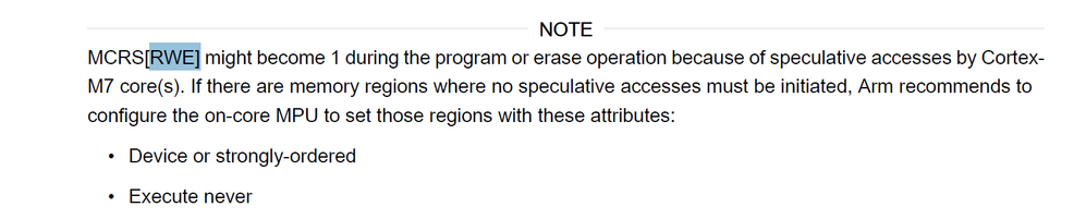

hi, The memory distribution of Application and Bootloader are as follows. If we want to erase and write Application while running in bootloader, and Ac load at startup has been enabled, do we need to configure the on-core MPU as mentioned in the second picture in PreTaskHook ?

Yes, it seems correct. If you are using MPU, I would recommend to setup it mentioned way.
