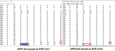

Hi Tom, @nxf10035
          I am working with my app based on MCAL(RTD 4.0.0) and bootloader recently. The issue is that loading app from start address 0x441004 faild after mcu reset. I captured two packet flow of my APP1.bin based on RTD 2.0.3 and my APP2.bin based on RTD 4.0.0 by PCAN-VIEW trace.  By contrast I found that a 0x784 packet is all zero instead of 211444 as below, which should be wrotten in address 0x441004.  And I found that there are some differences between APP1 linker file and APP2 linker file.  Would you provide some advise on it?
Looking forward to your reply.
Sylvia
