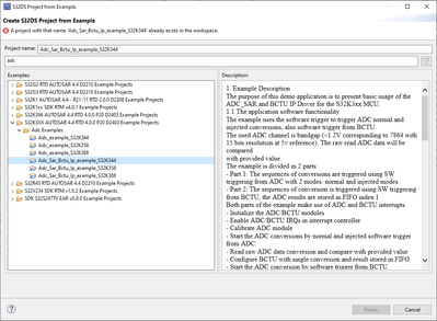

Hi @SAL_111,
The RTD packages include various examples for the modules. Have you used the ADC example as reference?
It shows how to use the APIs to configure, calibrate and start a conversion for the ADC:

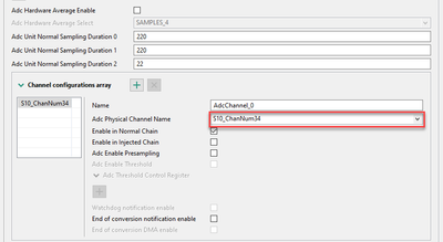

Julián_AragónM
Hi @SAL_111,
I'm not sure I understand, why is this example not valid for you? The example configures one ADC channel and reads the value for it in the notification function. You can simply modify the channel used for whichever channel you need to read.
For example, in the S32K344 EVB board, the included potentiometer is wired to ADC1_S10 (channel 34). You can simply modify the example to measure ADC1_S10 instead:
