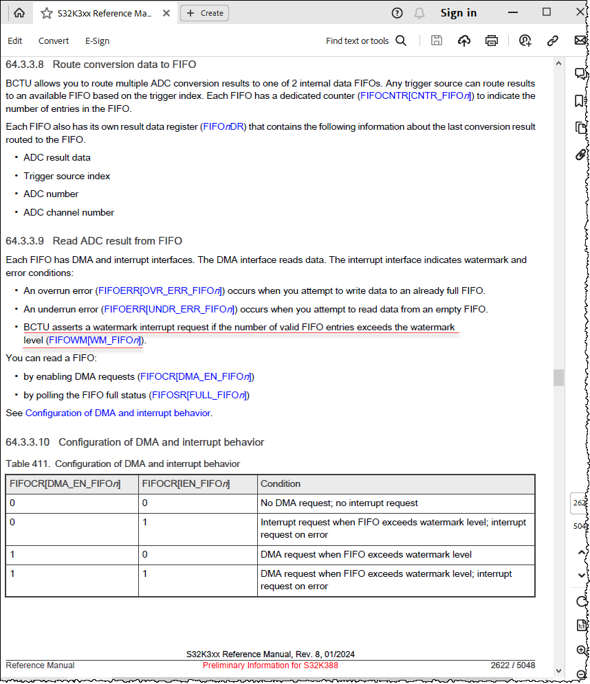

but i do have some doubt regrade to what is watermark value used for ??

Robin_Shen
BCTU asserts a watermark interrupt request if the number of valid FIFO entries exceeds the watermark level (FIFOWM[WM_FIFOn]).
