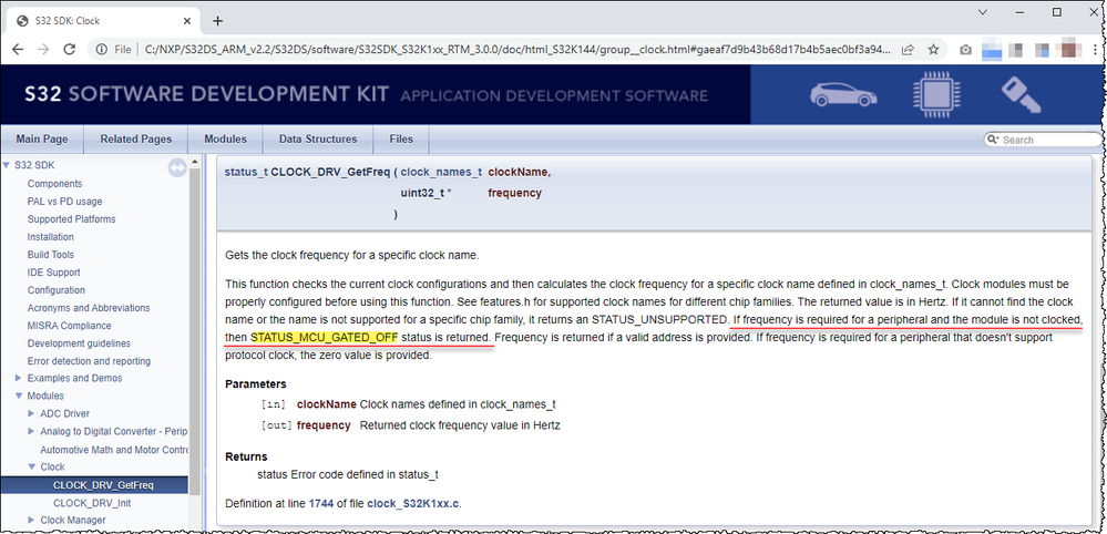

If frequency is required for a peripheral and the module is not clocked, then STATUS_MCU_GATED_OFF status is returned.
If frequency is required for a peripheral and the module is not clocked, then STATUS_MCU_GATED_OFF status is returned..pngIf frequency is required for a peripheral and the module is not clocked, then STATUS_MCU_GATED_OFF status is returned..png
Did you change the clock setting of ADC? Here you can check:

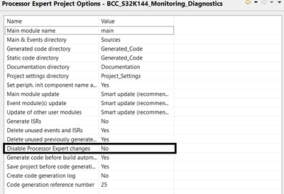

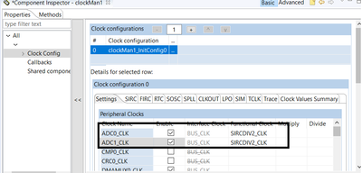

The code which I am debugging they configured the ADC similar to ADC configuration in ADC_swtrigger. Actually They have not added ADC component in the project but they have add the ADC configurations as driver folder. When I clock manager component clock for ADC0 and ADC1 are disabled.
Processor expert changes are blocked. So I tried to enable my processor expert and then I enabled the  clock for ADC0 and ADC1.

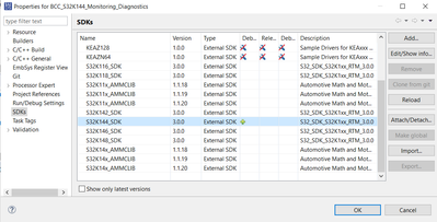

After enabling PE changes and enabling error occured regarding SDK retrieving
Earlier Kinetics SDK only enabled for the project so tried to add S32K144_SDk with this project.
After changes I came across below error which were not before changing the SDk properties.
Could you please help regarding this issue.
2,310件の閲覧回数
Robin_Shen
Would you please create new project with the latest SDK? Or use the old version SDK and enable related clocks.
