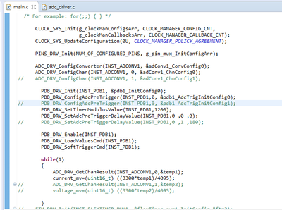

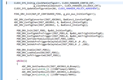

Hello Community,
I am trying to read the input supply ( voltage and current) through ADC1.
ADC1_channel 6 is to sense the Input current and ADC1_channel 7 is to sense the Input voltage.
I am triggering the ADC1 with PDB1,
At beginning I have sensed the ADC1_channel 6 Input current and I got output current_mv as 1290 mv.
Later I added the ADC1_channel 7 Input current,
When I sense the both ADC1 channel, the current_mv result are modified from 1290mv to 537mv .
My voltage_mv is correct as per my requirement but the current_mv values are changing once I added the 2nd channel ADC1_channel 7.
There is no changes in supply but I am getting different ADC result. I have attached my project for your reference. Please have a look and let me know where I am going wrong.

sarwath
I am suspecting my sample time and PDB timer and delay value. In my project I kept constant sampling time.
How to configure the different sampling time for different channels.

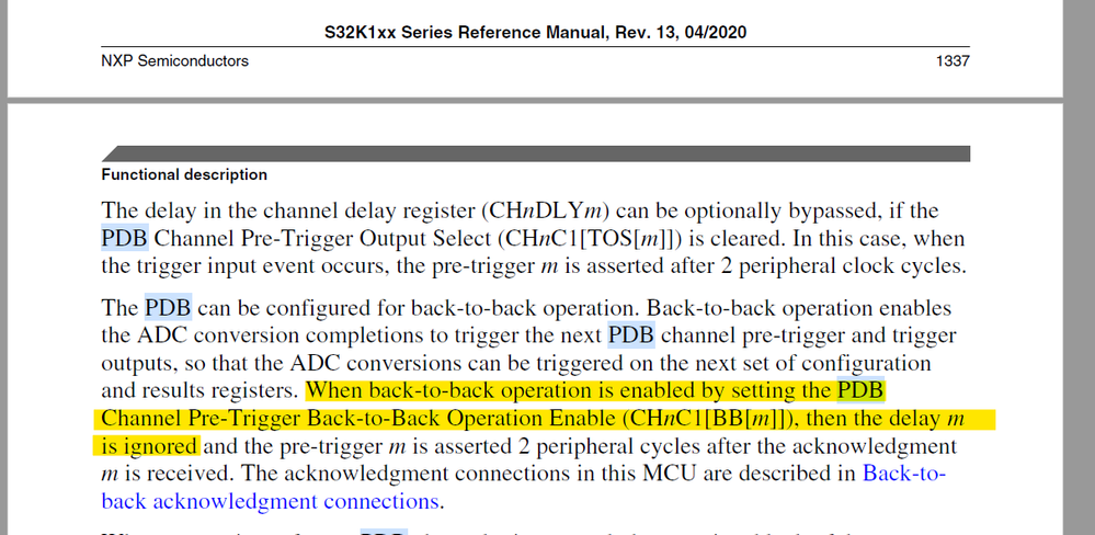

sarwath
Hello @davidtosenovjan ,
Yes david. In my Hardware the source impedance is 159Hz. It is less than 4Mhz only.
In RM, I read like,
I am using the back to back method only. I feel my PDB trigger causing the issues. How to calculate the PDB module value and delay values

sarwath
When I use the Software trigger for channel ADC1 CH6 , I am getting ADC result value closer to the Vin.
Then I configure the ADC (2 channels) with PDB trigger I am getting this value mismatch. I am reading RM and implementing but I am getting the wrong value in ch6 and ch7 value is valid (closer to the supply voltage). one channel value is correct and another channel value is wrong.
