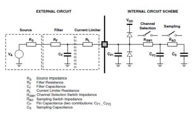

Question 1:
How to find the ADC acquisition and conversion time, RSW1, and RAD switch timing. Please explain it in detail so I understand it.

I was unable to get the answer by checking the method that you have shared for ADC timing, so please explain it to me in detail.

In the app note AN4373 Cookbook for SAR ADC Measurements you can found in more detail how to select your RC circuit for ADC based upon a selected acquisition time and other converter parameters.
