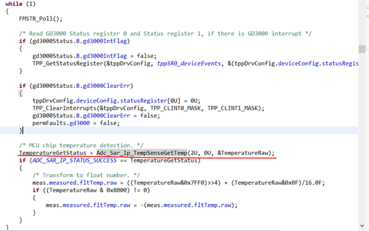

Hi@Simone9
In this demo (MCSPTE1AK344), there is a program that uses software to trigger the ADC to sample the temperature sensor, which should be the same as your needs.
1,186 Views
Simone9
I have seen these example but the API that you highlight is a specific API releated to the Temperature Sensor not for a generic ADC channel.
What I need is to understand how to set up the RTD driver and the API to call to schedule multiple SW triggered acquisitions, which do not interfere with BCTU acquisitions made via interrupt.

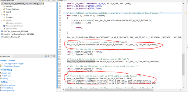

There are two ways for S32K3 software to trigger the ADC.
1.CPU->ADC
2.CPU->BCTU->ADC
In the RTD driver, we have provided ADC sampling example demos for these two methods.
You can refer to these two demos.
