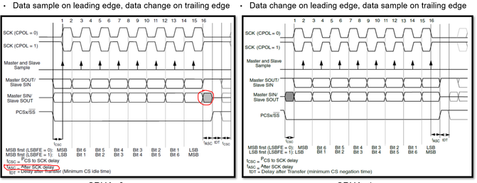

shunyizhang

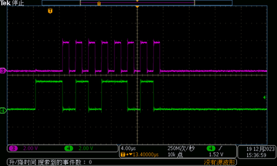

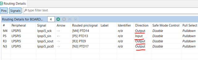

The green is MOSI and the purple is SCK
SPI:lpSPI5
SCK:PTD14
MOSI:PTE9
MISO:PTD13
CS:PTD17

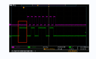

I periodically sent a 0x5a data, see the oscilloscope image, found that the MOSI pin first pull up two bits of time before the correct data transmission, why? In order to find the problem, I removed the SPI peripheral device, and the abnormal waveform still exists (even removed the SCK/MOSI pull-up resistance), so the problem is most likely in the MCU itself.

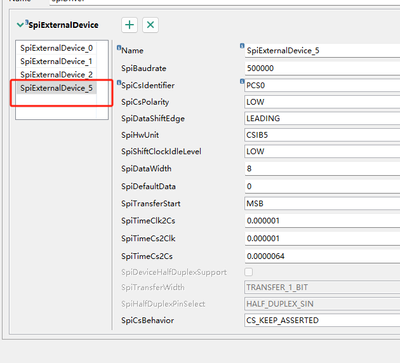

 SPI init:
    /* Configure pins */
     Siul2_Port_Ip_Init(NUM_OF_CONFIGURED_PINS0, g_pin_mux_InitConfigArr0);
//初始化SPI5
Lpspi_Ip_Init(&Lpspi_Ip_PhyUnitConfig_SpiPhyUnit_5_Instance_5);
    /* Update Transfer Mode */
    Lpspi_Ip_UpdateTransferMode(spiNum, LPSPI_IP_POLLING);
send data:
Lpspi_Ip_SyncTransmit(&Lpspi_Ip_DeviceAttributes_SpiExternalDevice_5_Instance_5, &data, &RxBuffer[eSPI5], 1, 10000);

Senlent
Hi@shunyizhang
I will confirm with my AE colleagues whether the tASC parameter can be changed (of course I think you can control the state of the MISO pin yourself after the transmission is completed), and I don’t think this will affect your SPI communication.

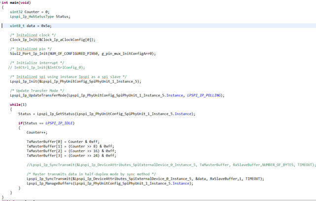

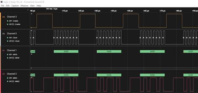

Senlent
Hi@shunyizhang
please double check your setting
MOSI:PTE9
MISO:PTD13
below is my test process , i don't see any problem

shunyizhang
Comparing my pictures, it seems that your pictures and mine also have raised parts, I am not sure if this part is normal.
2,062 Views
Senlent
Hi@shunyizhang
