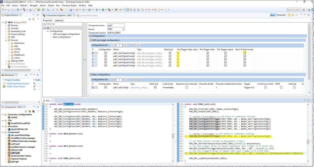

Hi community
I refer to the Example "Example-s32k144_pdb_adc_dma_SDK_rTM_300.7z"
ADC DMA and PDB are configured, but there is no DMA interrupt. Please help to see what is wrong with my configuration.
Attached is my project

Robin_Shen
Hi linglei_meng,
Please modify your project according to below images:
Hope it helps.
Have a nice day!
Robin
