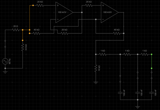

I'm using both ADCs on the S32K144.  I sense temperature through the MCP9701 with a 1k resistor in series.  On the other ADC I have a current transformer through an op amp rectifier circuit then a filter circuit with three 1k resistors in series and a 100nf cap to ground after each resistor.

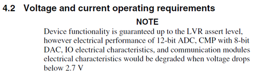

One problem I noticed is that I'm using a 2.048V voltage reference but the datasheet seems to say the voltage reference is limited at 2.7V up to Vdda (which is 5V for me, I have vdd and vdda tied together at the chip with separate bypass capacitors).

One of the failed boards could have seen a voltage spike on the ADC input, though I would have thought the op amp would have limited the voltage spike from the CT.  This spike happened on 5 boards and only 1 board is having ADC problems after I replaced the op amp that was fried.

It is hard to say, but the low-voltage reference does not seem to be the issue, going below the minimum for the VREFH is more related to not commit with the ADC TUE performance specified.

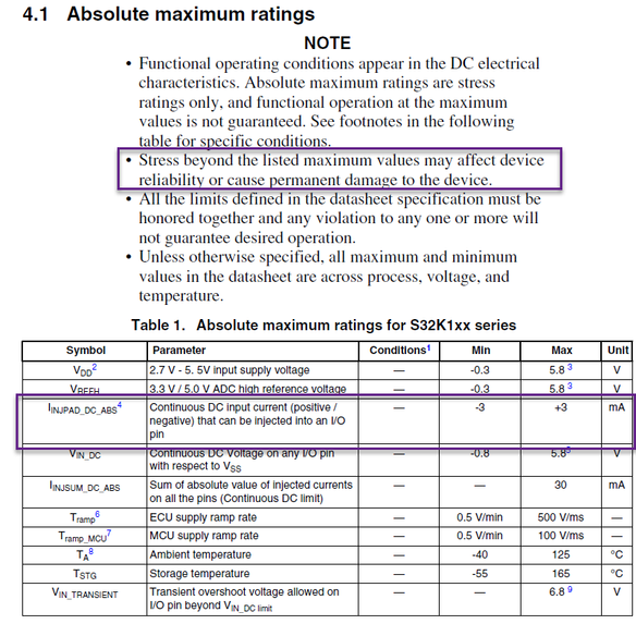

The ADC could be damaged by current injection on the ADC input when Vin > VDDA or Vin < VSSA.

I ran simulations and was unable to get anything over 2mA but I have to assume that was the issue.  Maybe there was a short spike that got through the op amp, though the op amp doesn't seem to be burned up on at least 2 of the 3 boards.  Not sure on the 3rd board.
I also haven't completely ruled out ESD but either way it's the same issue.
At any rate, I will put diodes on the next version to mitigate this issue as much as possible.

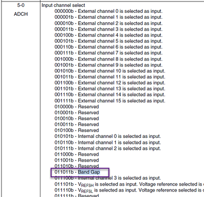

danielmartynek
Hi @sparkee,
Have you tried the ADC modules at different inputs?
Maybe only the pins got damaged.
The Band Gap internal channel should give you a good reference.
BR, Daniel

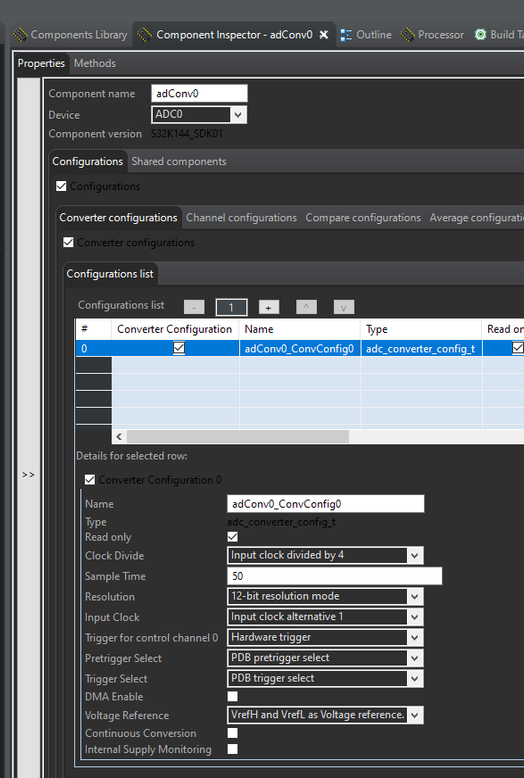

(RECAP) So my custom board has been running this software for almost a year with only minor tweaks and now the ADC has stopped reading correctly.  If I put ADC example software on the custom board, ADC works again.
(NEW) If I put MY software on the 144DEV board, it works fine.  So my software does not work on my board but does work on the dev board.  Both boards work with the example software.
I use the SDK implementation for my software, whereas the example does not utilize the SDK.
I'm still working on it but this is a really strange issue.
Here's my ADC setup.  I use the PDB to trigger the ADC every 100us.
