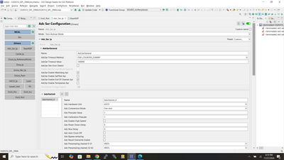

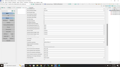

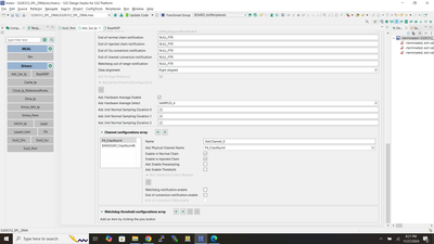

We are trying to configure PTE16(ADC0) pin in the S32K312 MCU using S32 DS 3.5. We need to read the voltage level on that pin and need to control the pin accordingly. For your reference, find the details in the below image.
SasiKumar_Vengam_0-1732719001998.pngSasiKumar_Vengam_0-1732719001998.pngSasiKumar_Vengam_1-1732719019049.pngSasiKumar_Vengam_1-1732719019049.png
We configured this using an example, they have used interrupt. But we prefer to configure without using the ISR function.
Any simple implementation of ADC without ISR would help.
