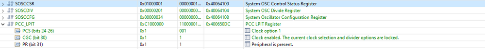

I really hoped you wouldn't say this was a hardware issue. I can share the .elf file for my main project so that you can test it in your hardware. If you have S32K118 EVB, this code should change the colour of the RGB LED every at every two seconds (Blue -> Green -> White -> Red). If it is also changing its value at every two seconds in your hardware, then it cannot be a hardware issue, right?
I will also build a sample project from the SDK and test it as you have suggested.
7,927件の閲覧回数
talha_uyar
I have built lpit_periodic_interrupt_s32k118 example project and it is working fine. It is overflowing exactly at the expected time. I don't think the issue is with the hardware.
I am almost certain that the associated clock for the LPIT in my project has the frequency of 20 MHz instead of 4 MHz. I have no idea why but this is almost definitely the source of my problems.

namnguyenviet
Probably the CLK source for LPIT is too much high, leads to CVAL (Counter value) decreases too fast. Please check your PCC and SCG registers:
Nam
7,927件の閲覧回数
talha_uyar
I think the register values are the same.
I also think this about me using the wrong clock source. When I call the function Gpt_StartTimer(Sample_Timer, 24000000) it overflows at 1 second. This kind of indicates that I am using SYS_CLK instead of SOSCDIV2 which is at 24 MHz instead of 4 MHz. I cannot understand why, though.
