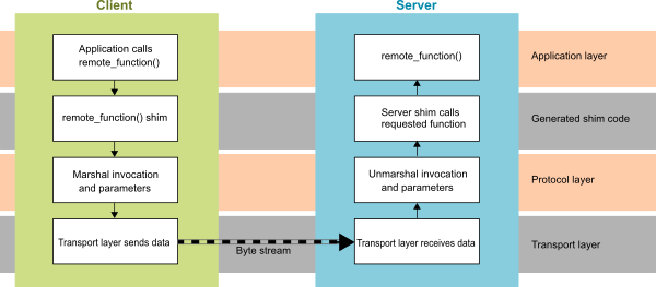

The eRPC (Embedded Remote Procedure Call) is a Remote Procedure Call (RPC) system created by NXP(https://github.com/EmbeddedRPC/erpc/). An RPC is a mechanism used to invoke a software routine on a remote system using a sample local function call.
eRPC software architectureeRPC software architecture
Figure 1. eRPC software architecture

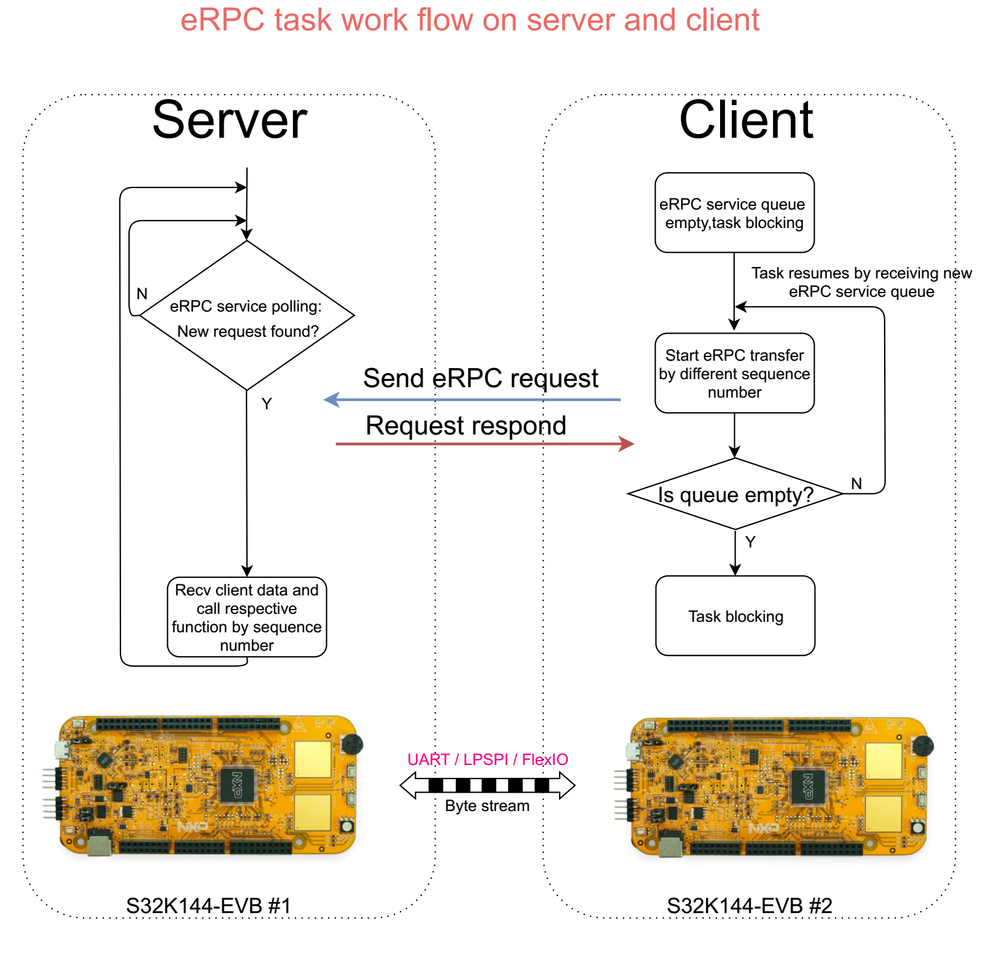

Two S32K144EVB boards are connected to demonstrate the usage of the eRPC protocol. One works as the client, another as the server. The client board starts an eRPC request and the server board responds to the request and executes the service.
Figure 2. eRPC task workflow on S32K144-EVB

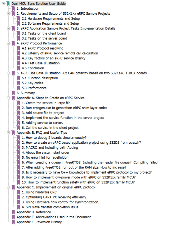

Please find the attached sample projects and user guide for more details.
Figure 3. Table of Contents in User Guide
