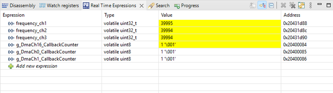

5. Example Project Demonstration
This example program is based on the S32K344, using RTD version 7.0.1.
It implements the function of acquiring the pulse frequency input from PTB26, PTA18, and PTA19 pins.
1.The timer is set to 1 second; the count value read in 1 second can be directly used as the measured frequency.
2. The maximum value of the CITER register is 0x7FFF, or 32767. When the count value exceeds 0x7FFF, the register will be reloaded with an initial value of 0x7FFF..
3. CITER triggers a DMA interrupt during reload. "g_DmaChx_CallbackCounter" can be used to record the number of overflow reloads.
4. Based on CITER and "g_DmaCh16_CallbackCounter", high-frequency pulse input counting can be achieved.
5. To measure an input frequency of 40kHz, connect the signal generator's output signal to PTB26, PTA18, and PTA19.
6. Test result in S32 DS.
       Using the Siul2 module to trigger DMA for counting is a very efficient method, but it should be noted that if other eDMA transfers are enabled in your application, more testing is required to ensure stable execution of all eDMA channels.
