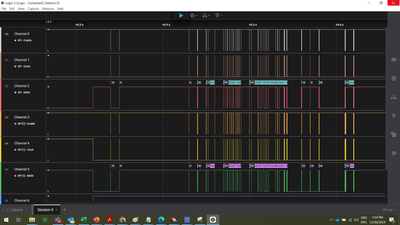

This example code brief  :--

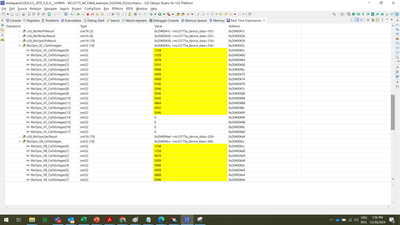

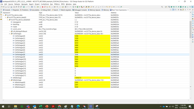

This example does this task :--
  1. Application Measurement.
  2. SYNC measurement
  3. Periodic Measurement.
  4. Read AFE temperature.
  5. Cell balancing timer method.
  6. Reading the Cell balancing status register & fault registers.
=================== Setup used ============
Attached code is tested with TWO MC33775 AFE connected in TPL mode.
=============== MCU Pins used ===========
TPL1-TX :--
TPL1TXCSB  --> PTC6/LPSPI0_PCS1
TPL1TXSCLK --> TPL12TXCLK --> PTE1/LPSPI0_SCK
TPL1TXDATA --> TPL12TXDATA --> PTE2/LPSPI0_SOUT
TPL1-RX :--
TPL1RXCSB  --> PTB17/LPSPI1_PCS3
TPL1RXCLK  --> PTB14/LPSPI1_SCK
TPL1RXDATA --> PTB15/LPSPI1_SIN

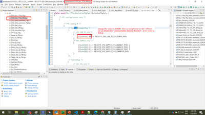

============= Using Debugger ============
Debugger breakpoint will cause the communication timeout at the AFE, which will RESET the AFE. To use the debugger while development you need to disable the communication timeout.
In S32DS MEX file you cannot disable the timeout function ( limit the value of 0~255)
Disable Communication timeout in code :--
================= Results for FIRST AFE ===========================
